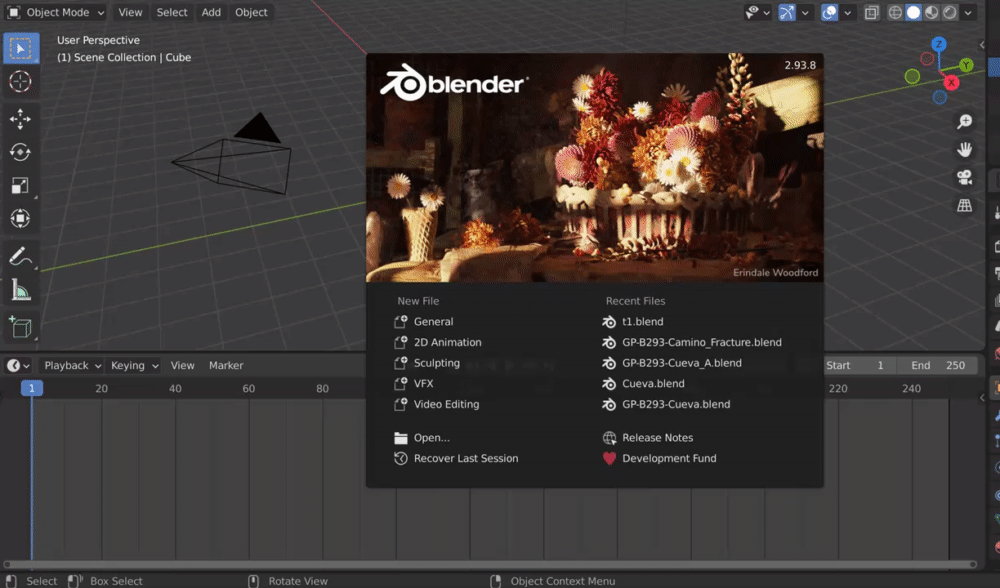

When drag the Playhead, there's a big delay compared to previous versions.

With a friend, we saw that this issue happens when Material Preview is showed:
  • With Mat Prev open:
https://i.gyazo.com/4b2a5acb0e0267bda4e93a4f1a8644c7.mp4
  • W/O Mat Prev:
https://i.gyazo.com/7bada6a48a13a23042940e0853aa4cde.mp4

The original issue wasn't fixed by loading factory settings, only make it better cause Material Preview wasn't showing.
The testing file before factory settings was a cube and a plane with simple materials.
It is not an improvement request, but a bug, since it is related to a previous version funcion that was working well, the material preview, and now isn't.
Now when the Mat Preview is showed, there's an issue with performance that one can see it easy by dragging the Playhead.

In video of your original report,was material preview open?
If yes, it's indeed a same problem- T94648: Timeline scrubbing is laggy when Preview tab is open in Material Properties
